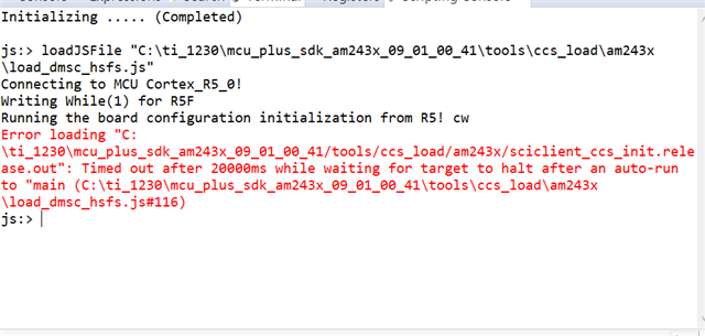

My customer use AM2432 and found they have problem using CCS script after debug.
Any idea for the error since we don't get necessary debug message during this stage by adding debug log in project.
We suspect it could be download image for CCS script will be different for AM2432 and AM2434.
Is there CCS script for AM2432?

    Customer has no problem to launch script and debug on AM243-LP EVM with HS-FS AM2434.
    Same setting is not working on customer board with HS-FS AM2432.
    Is there any change required for this script while working on AM2432?
    BR, Rich
  • Tushar,
    We have tried UART boot and being able to load project and run on this board but now is no way to download project via CCS directly in No boot mode.
    BR, Rich

    If customer is using HSFS device than NO boot mode will not work. DEV Boot mode is mandatory for HSFS device. Please try to run the script while keeping board in DEV boot mode.

    Yes, customer has followed the recording video and do the steps manually. After loading, there is no response and not jump to main.
    Customer recoding video clip is attached.
    https://e2e.ti.com/support/microcontrollers/arm-based-microcontrollers-group/arm-based-microcontrollers/f/arm-based-microcontrollers-forum/1329122/lp-am243-initialization-script-is-not-working/5059716#5059716
    One thing I noticed is the e2e recording video is based on AM64x and now customer is using AM2432 (not AM2434).
    Not sure if this creates difference.

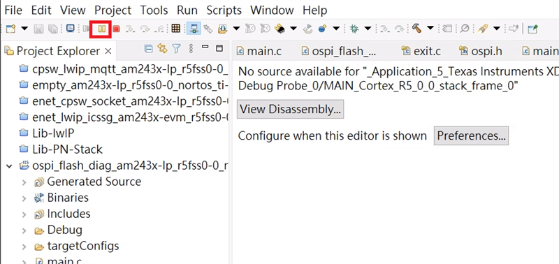

    Can you please pause the program and check where it is getting stucked? Also can you please share the disassembly view after pausing the program?
    Can you please confirm that the device type used is HSFS not the GP one?
    Can you please share the complete UART logs obtained by keeping the device in UART boot mode?

  • Hello Rich,
    Let me check if we can do pause because there is no response after loading project.
    You can click on the pause button after loading the program on R5F core. Please see the below screenshot to see the pause button.
    Tushar
  • Hi Tushar,
    1. pause the program
    2. the disassembly view after pausing the program
    3. UART logs obtained by keeping the device in UART boot mode
        Our device should be HS-FS device.
    BR,
    Chaowen

  • Hi Rich,

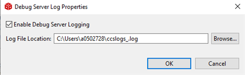

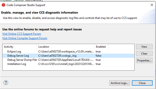

    Can you please try to get the Debug Server logs from CCS and share it with us?
    Steps to turn on CCS Debug server logs are given below.
    1. Open CCS, go to help -> CCS support.
    2. Open the properties for Debug Server Log.
    3. Enable Debug Server log and provide the path of file where you want to save the logs.
    4. After enabling the Debug Server log load the sciclient_ccs_init.release.out file and run it.
    Also can you please share the sciclient_ccs_init.release.out file used ?
    Tushar
  • Hi Tushar,
    I have used two different modules for testing and generated two sets of logs.
    I have also attached sciclient_ccs_init.release.out for your reference.
    sciclient_ccs_init_log.rar
    BR,
    Chaowen

  • Hello Choawen,
    Can you please confirm, is the program able to jump to _c_init00?
    Please follow the below debugging steps.

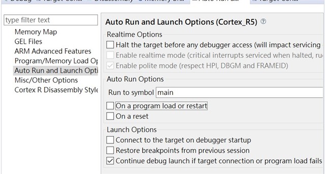

    • Build the sciclient_ccs_init example in debug mode.

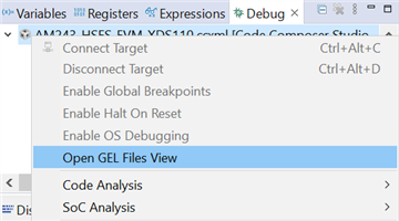

    • Launch the target configuration file and right click on the Cortex_R50-0 core and open the GEL view.

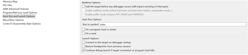

    • Do the following setting in Auto Run and Auto Launch option.
    • Connect the core and load the program.
    • Step over and see whether the code is going to _c_init00 or not.
    Tushar
  • Hi Tushar,
    I think the program did not enter _c_init00.
    Additionally, I have attached the settings and a recording for your reference.
    check whether jump tp _c_init00.rar
    BR,
    Chaowen
  • Hello Chaowen,
    Thanks for sharing the above details.
    I understand that the program is not going to _c_init00. Can you please also record the value stored at memory address 0x0 when you step over after loading the binary?
    Also can you please confirm, are you able to initialize the custom board using the SBL binaries?
    Are you able to load basic examples(say hello_world) while the board is initialized with SBL binaries?
    Tushar
