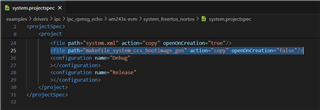

I just spend a frustrating day debugging some very strange memory stomping.
In the end it turns out that makefile_system_ccs_bootimage_gen was adding in a project that had been removed from system.xml several months ago. I expanded the memory footprint of one of the other projects and it was a block that the removed project had used. bootimage_gen was layering the removed project image over the rest...
Pretty frustrating since all the rest of the build works as expected.
How is makefile_system_ccs_bootimage_gen generated? Is there I re-generate trigger I disabled somewhere?

    The System project `makefile_system_ccs_bootimage_gen` isn't generated but just included on importing the project in CCS. This makfile gets included with the following highlighted line shown below
    If you don't want to include this makefile in case you have your own makefiles to generate bootable images, you can delete this line. Ofcourse then you also have to remove the post build steps in `System.xml` which uses this makefile to generate the appimages.

    I disabled cores I was not using via the system.xml CCS gui. The project had the possibility of using all cores but a goal of using as few as possible, hence the reason I started with all cores.
    Later in the project, I rearranged the memory blocks used by each of the three R5F cores I was using to suit my needs, expanding into the region that the 4th core had used.
    Still later, the project stopped working when I wasn't debugging. Eventually I figured out that the image for the 4th core was being included in the multicore image, overlapping the image of the processors I was using.
    The issue is that even though I had the 4th core disabled in the system.xml (which the build and debug machinery in ccs all obeys), the system build was adding the 4th core image to the multicore image.
