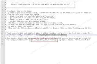

My customer is flashing the sbl_null for their custom board. They are using sbl_dfu_uniflash to do so.
They've tried two .cfg for the python script.
First, they uses the following cfg

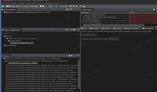

The python script is successful. However, after they switched back to ospi boot and power cycle, there is no output on the uart terminal. As they connected to AM243x, they saw the core is stuck at 0x418019f0, which should be a in the RBL.

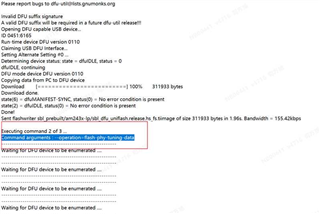

Secondly, they've tried the default_dfu_uniflash,
However, the script failed at the second command.
