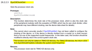

      First of all, there is an example for systick at C:\ti\TivaWare_C_Series-2.2.0.295\examples\peripherals\systick. Please use this example.
      I'm not sure how your implement your custom GetClkSpeed() function. If GetClkSpeed() calls SysCtlClockGet() then it will not work. SysCtlClockGet() is an API only for TM4C123. You cannot use SysCtlClockGet() forTM4C129. It will produce unexpected behavior.
