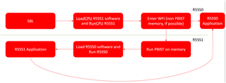

we are using AM2632 and I have a question about the possiblities of bootflow.
We use the AM2632 in lockstep mode, so we have two available cores (R5SS0 and R5SS1)
Is it possible to load firmware to R5SS1 from SBL and then start the firmware on R5SS1.
In the next step the R5SS1 should load firmware from flash to R5SS0 and start this on R5SS0.
Is this sequentiell load of firmware images possible(SBL loads to R5SS1 laods to R5SS0) ?
Background of my question is the execution of pBIST on R5SS1 (which tests R5SS0 memory areas), before loading firmware to R5SS0.

  • Hi Jo,
    Please find the Application Note explaining the subset device configuration -
    https://www.ti.com/lit/an/sprada3/sprada3.pdf
    Yes this is possible.
    In this case, default SBL flow will not work for you. You need to put your CPU into WFI after the runCPU is called for R5SS1_0.
    After this step you can call the runCPU functions from R5SS1_0. As this use case is something, we have never tried you might have to change drivers at a few location.
    It sounds possible to me, but will require some of the changes.
    This will be the flow diagram for the same.
    I hope this helps.
    Aakash
