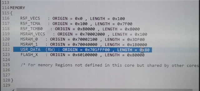

Customer use Section name“.bss.user_dat” to Initialize one time, when warm reset or watchdog reset, these Section name“.bss.user_dat” do not change again, so it will keep these Section name“.bss.user_dat” Content.
But customer use "NOLOAD", it does not work. Could you help look into this feature by ARM compiler? Thanks.
USR_DATA  (RW):ORIGIN = 0x701FFF00, LENGTH = 0X80.
