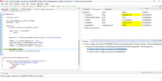

I'm working on an application for the MSPM0L1306 that uses the internal temperature sensor. I have modified the adc12_single_conversion example to use the internal temperature sensor (Channel 11) and 1.4V internal reference. With the development board in my desk, I'm getting values around 1899 and the TEMP_SENSE_0 value for my chip is 367.
below is the code snippet:
while (1) {
DL_ADC12_startConversion(ADC12_0_INST);
while (false == gCheckADC) {
__WFE();
gAdcResult = DL_ADC12_getMemResult(ADC12_0_INST, DL_ADC12_MEM_IDX_0);
VSAMPLE = (1.4/4096)*(gAdcResult - 0.5);
TEMP_SENSE_DATA = FACTORYREGION->TEMP_SENSE0;
VTRIM = (1.4/4096)*(TEMP_SENSE_DATA - 0.5);
TSAMPLE = (1/-0.00175)*(VSAMPLE - VTRIM)+30;
gCheckADC = false;
DL_ADC12_enableConversions(ADC12_0_INST);

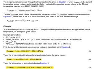

Plugging these values into the formulas from section 2.2.5 Temperature Sensor of the TRM manual I get the following:
VSAMPLE = (1.4 V / 4096) * (1899 - 0.5)  = 648.9 mV
VTRIM = (1.4 V / 4096) * (367 - 0.5) = 125.2 mV
TSAMPLE = (648.9 mV - 125.2 V) / (-1.75 mV / °C) + 30°C = -269.21 °C
This value is not realistic. However, when using the VTRIM from the example in the manual, I get much more plausible results:
TSAMPLE = (648.9 mV - 634.5 mV) / (-1.75 mV / °C) + 30°C = 21.79 °C
