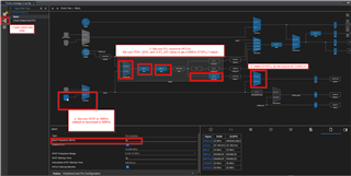

Hi TI Team.
Q1. i have designed a ckt with MSPM0g3507 MCU and i used 16MHZ of an external crystal,
- and i am using Mcan_message_rx example code. what settings do i want to change in syscfg so that CANCLK gets 40 Mhz?

  • Hi Prajesh,
    See this image:
    Since the example uses the 40MHz Crystal directly, you will want to change it to use the SYSPLL to generate your CANCLK.
