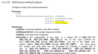

      I don't see you configure PE3 for AIN_0. You need the below line.
    GPIOPinTypeADC(GPIO_PORTE_BASE, GPIO_PIN_3);
      Please refer to the examples in TivaWare SDK at C:\ti\TivaWare_C_Series-2.2.0.295\examples\peripherals\adc

      I will suggest you isolate the problem. First, just sample the data and read out the data without any of the floating operation. Are you getting the correct value that is stored in the ADC FIFO? This will tell if the problem is related to your floating operations. If the ADC is correct in sampling the correct value then you can investigate further on the float calculation. Since you are using floating operations, you need to make sure you have sufficient stack. Try to increase your stack and heap memory.
  • Hello!
    I isolated the ADC sampling, the sampled values ​​do not correspond to those expected,
    for the same ADC channel and a fixed resistance value, the ADC samples are changing,
    but when I apply a voltage of 3.3V (which is the supply voltage ) the ADC values ​​remain static.
    best regards
    Mayra
      You have the below code. You are configuring PE3, PB3, PD3 and PK3 for ADC. Is that what you want?
    GPIOPinTypeADC(GPIO_PORTE_BASE,GPIO_PIN_3); //PINES PARA ENTRADA ADC0
    GPIOPinTypeADC(GPIO_PORTB_BASE,GPIO_PIN_3); //PINES PARA ENTRADA ADC0
    GPIOPinTypeADC(GPIO_PORTD_BASE,GPIO_PIN_3); //PINES PARA ENTRADA ADC0
    GPIOPinTypeADC(GPIO_PORTK_BASE,GPIO_PIN_3); //PINES PARA ENTRADA ADC0

  • I'm confused now. On one hand, you want to sample channels on PE3, PB3, PD3 and PK3 but on your earlier posting you have the below code. Are you sure you want to sample AIN12 and AIN19? our code says you are trying to sample AIN0 eight times. You have 0 as the fourth argument for each of the 8 steps in the Sample Group 0.
    ADCSequenceConfigure(ADC0_BASE, 0, ADC_TRIGGER_PROCESSOR,0);
    ADCSequenceStepConfigure(ADC0_BASE, 0,0, 0);//(paso 1)
    ADCSequenceStepConfigure(ADC0_BASE, 0,1, 0);//(paso 2)
    ADCSequenceStepConfigure(ADC0_BASE, 0,2, 0);//(paso 3)
    ADCSequenceStepConfigure(ADC0_BASE, 0,3, 0);//(paso 4)
    ADCSequenceStepConfigure(ADC0_BASE, 0,4, 0);//(paso 5)
    ADCSequenceStepConfigure(ADC0_BASE, 0,5, 0);//(paso 6)
    ADCSequenceStepConfigure(ADC0_BASE, 0,6, 0);//(paso 7)
    ADCSequenceStepConfigure(ADC0_BASE, 0,7, 0|ADC_CTL_IE|ADC_CTL_END);//(paso 8)

  • Most of your code is commented out. Why don't you focus your code for one channel on one sensor. Remove all the commented out code. I also don't see in your latest code which pin is used like PE3 or whatever pin you want to use to sample. Where in your latest code do you have GPIOPinTypeADC()? For good readability, do NOT write like below.
    You should write like below instead. It helps other people who is reading your code and it also help yourself.
    ADCSequenceStepConfigure(ADC0_BASE, 0,0, ADC_CTL_CH0);//(paso 1)
    I will suggest you just sample only one channel one time instead of 8 times. See it that works. Also run the same on a LaunchPad. I don't know if and how your hardware is playing role in the sampling as you have multiplexers outside. How are you controlling the multiplexer. Again, start with something simple and expand gradually per your application requirement. Do one channel sampling on a LaunchPad and then add another channel. If everything works, move on to add more channels and then finally test the firmware on your own custom board.

      ADCSequenceStepConfigure(ADC0_BASE, 0,6, 2);//(paso 7)
      ADCSequenceStepConfigure(ADC0_BASE, 0,7, 2|ADC_CTL_IE|ADC_CTL_END);//(paso 8)
      ADCSequenceEnable(ADC0_BASE,0);
      ADCIntClear(ADC0_BASE,0); //limpia las banderas de interrupción del ADC
      ADCProcessorTrigger(ADC0_BASE,0); //Causa un trigger para una secuencia de muestreo
      while(!ADCIntStatus(ADC0_BASE,0,false)) //indica el estado de las interrupciones
      ADCSequenceDataGet(ADC0_BASE,0,buffer_ADC);//obtiene los datos capturados por el adc
      mu_T=(buffer_ADC[0]+buffer_ADC[1]+buffer_ADC[2]+buffer_ADC[3]+buffer_ADC[4]+buffer_ADC[5]+buffer_ADC[6]+buffer_ADC[7])/8;
      vol_T=mu_T*3.3/4096; //aqui hubo breakpoint
      RT=((3900*(3.3-vol_T))/vol_T);
      T=(1/(0.000634544+(0.000321866*log(RT))+(-0.000000306*pow(log(RT),3))))-273.15;//aqui hubo breakpoint
      arreglo[8]=T;
    //ENTRADA S2
      GPIOPinWrite(GPIO_PORTD_BASE, GPIO_PIN_5, 0x00);//IN2
      GPIOPinWrite(GPIO_PORTD_BASE, GPIO_PIN_4, 0xFF);//IN1
      ADCSequenceStepConfigure(ADC0_BASE, 0,0, 2);//(paso 1)
      ADCSequenceStepConfigure(ADC0_BASE, 0,1, 2);//(paso 2)
      ADCSequenceStepConfigure(ADC0_BASE, 0,2, 2);//(paso 3)
      ADCSequenceStepConfigure(ADC0_BASE, 0,3, 2);//(paso 4)
      ADCSequenceStepConfigure(ADC0_BASE, 0,4, 2);//(paso 5)
      ADCSequenceStepConfigure(ADC0_BASE, 0,5, 2);//(paso 6)
      arreglo[9]=T;
      //ENTRADA S3
      GPIOPinWrite(GPIO_PORTD_BASE, GPIO_PIN_5, 0xFF);//IN2
      GPIOPinWrite(GPIO_PORTD_BASE, GPIO_PIN_4, 0x00);//IN1
       arreglo[10]=T;
       //ENTRADA S4
       GPIOPinWrite(GPIO_PORTD_BASE, GPIO_PIN_4, 0xFF);//IN2
       GPIOPinWrite(GPIO_PORTD_BASE, GPIO_PIN_5, 0xFF);//IN1
       arreglo[11]=T;
