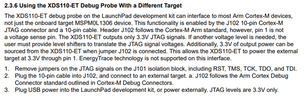

I am writing to inquire about the debugger selection for our custom board.
Our custom board features an MSPM0L 1306 MCU and the ARM Cortex Debugger (10-pin) connector. I have been utilizing the XDS110 debug probe embedded in the LP-MSPM0L 1306 Development Kit to program/debug our firmware in SWD mode.
My questions are as follows:
  1. Can we possibly utilize the embedded debug probe on a LP-MSPM0L 1306 Development Kit to program/debug our firmware on our custom board?
  2. If not, would the standalone XDS110 Debug probe (TMDSEMU110-U) be the right choice for our use case?
Here is the link to the website I have been navigating to learn more about TI debugger options.
