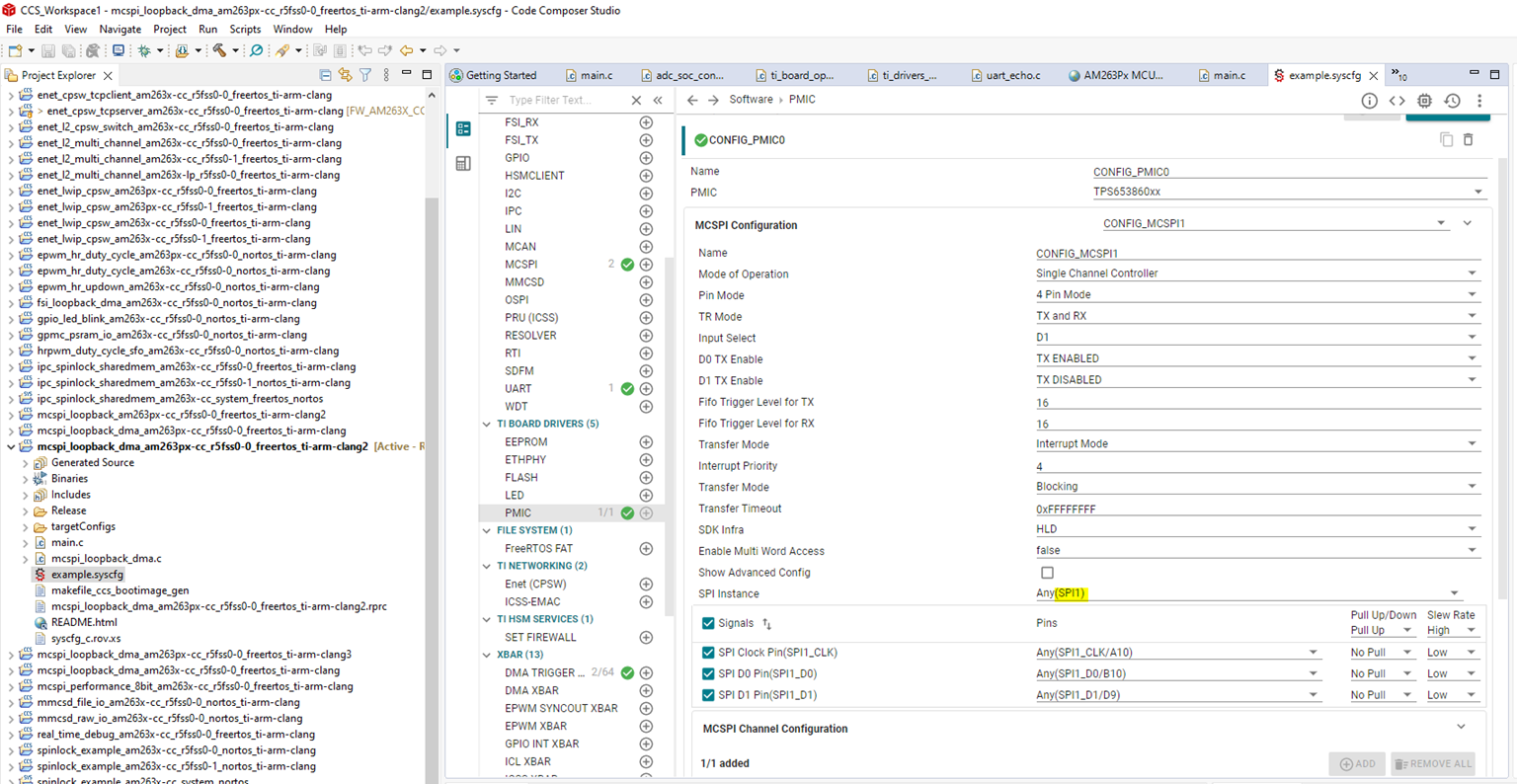

I am porting a project from AM263x to AM263Px.
My project AM263Px includes the PMIC TI Driver.
I noticed if I include a second MCSPI module with Transfer mode = "DMA Mode", I see errors on the Console:
  [Cortex_R5_0] ERROR: Drivers_mcspiOpen:169: MCSPI open failed for instance 1 !!!
  ERROR: Board_pmicOpen:96: PMIC open failed for instance 0 !!!
I noticed that there are multiple calls to Drivers_mcspiOpen() in the SysConfig generated code,
However, if I switch the second MCSPI module to Transfer mode = "Polled Mode", the errors are not printed in the Debug Log.
What is the cause of this error?
Screen captures of SysConfig follow:
