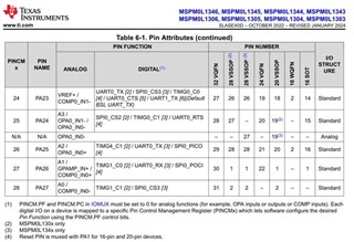

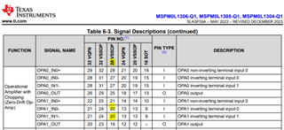

Could you please explain the following mismatch.
The slau847c contains the following configuration:
The data sheet then states that OPA_IN1- and OPA_IN0- are bonded to the same PAD.
What is correct? Above all,  concept of amplifying two external signals with the same OPAMP would not be feasible.
