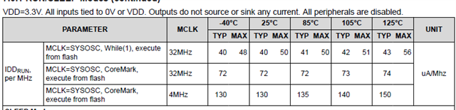

customer has may IDD=100uA and has to measure a slow signal (20sps). He want to reduce current for CPU and ADC. In the datasheet the IDDRUN is 0.52mA at 4MHz (SYSOSC). How much would it be with 1MHz or 500kHz?
What about the ADC. In the d/s it is stated 300uA at 200ksps. Can I run it with 1ksps? What is the consumption then?
He knows that he has to use a cap to store the energy and switch between different standby/stop/run mode. But less average current means lower cap.
