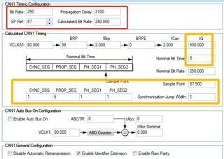

For the content in the yellow box, what means can be changed according to customer needs?

Basically the CAN bit period can be subdivided into four time segments. Each time segment consists of a number of Time Quanta (tq). The Time Quanta is the smallest time unit for all configuration values. The Time Quanta (tq) is determined by baud-rate and BRP.
Time Quanta tq: (BRP+1)/CAN_CLK
Number of Quanta: CAN_CLK / [Baud-rate * (BRP+1)]
There are several options for number of time quanta and length of segments (Tseg1, Tseg2) for a given baudrate. The HALCoGen only gives one option, that might not be the best choice for your application.
The number of segments are not changeable from the HAL GUI, but you can change them in the HAL generated source file: can.c

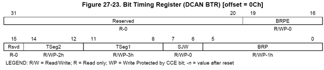

You can program the time segments to CAN timing register:
canREG1->BTR &= 0xFFFF003F;
canREG1->BTR |= (TSeg2 << 12U) | (TSeg1 << 8U) | (SJW << 6U);
The threshold of transmit error to trigger CAN Bus-Off can not be changed.
