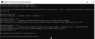

I am trying to update my SDKs to the latest 09_01_00_41, however, I am having trouble flashing the SOC Initialisation Binary.
I am following the advice in this page:
https://software-dl.ti.com/mcu-plus-sdk/esd/AM243X/08_06_00_45/exports/docs/api_guide_am243x/EVM_SETUP_PAGE.html#EVM_FLASH_SOC_INIT
I have set the boot switches to UART BOOT MODE (11100000).
Connected both USB cables verifying that the power LEDs are correctly illuminated (LED6,7,8 and 11 only)
I then attempt to flash the mcu with the null config and it successfully sends the flashwriter and fails on the null image as shown below:
Can you please provide some suggestions as to how I can fix this issue?
