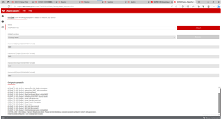

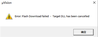

Previously, MSPM0C1104 was able to use JFLASH to download programs. Recently, it is unknown whether it is due to installing packages for other chips or downloading incorrect programs, resulting in the inability to find SWD on the KEIL page and download programs. Even if the chip is erased, the program cannot be downloaded. What should I do%MCEpastebin%
    1). Try again with another C1104 chip because the chip you used maybe locked.
    2). Try again with another code file to check whether the error is caused by your application code.
    3). Try again with other programming tool to check whether the error is caused by J-LINK. And it is important for you to confirm your JLINK configuration is right.
