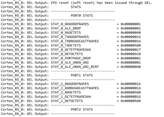

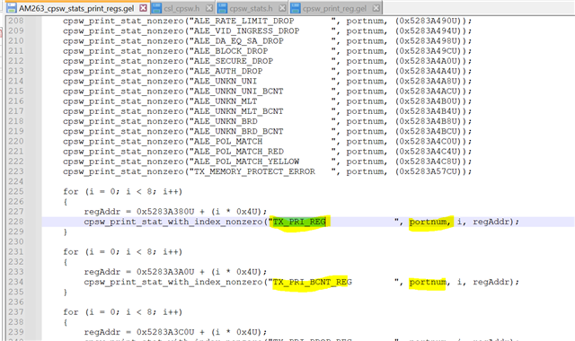

  • Hi Shaunak & Harish,
    Could you please explain the images below.
    I have configured Port1 only & there are some STATS in Port0 & Port2 as well.
    Addresses in AM263_cpsw_stats_print_regs.gel , not found in Datasheet & Register manual.
     MCAL Demo:
    My Application:
    Kind regards,
    Hari
  • Hi Hari,
    In MCAL demo as well PORT 2 not using, STATS wrt PORT2 showing in MCAL Demo due to bug/issue in Gel file. As per Am263 Register Addendum TX_PRI_REG and TX_PRI_BCNT_REG are common registers with priority 0-7, but in AM263_cpsw_stats_print_regs.gel file mapped to port number as well. In your Application after successful transmit you can also see these Stats.

  • Hi Harish,
    In the images above, TX & RX frames are showing in PORT1 for MCAL demo, but in my case TX frames are showing in PORT0 & RX frames in PORT1.
    I have checked gel files, PORT0 & PORT1 address are different.
    What could be the reason TX frames showing in PORT0 in my application, even i have configured PORT1 only.

  • Hi Hari,
    Port 0 is Host port, Port1 and 2 are external Ports. Tx frames are not routing to external Ports. this can be happen if Mac address not updates in ALE table. But in your case it is updating in ALE table and we tried in debug call with Broadcast address(which will be updated in ALE table during init) as well.

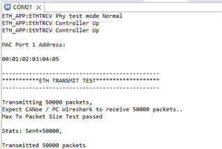

    I see the Tx working. I verified by sending 50,000 packets from the Microcontroller. I will attach my wireshark snippet and all the configuration files I used.
    Please note that you might find some differences in my config files. The changes were done in order to resolve build errors.I am also attaching my Eth_App demo files.
    Wireshark snippet: (IPV4 frames from MCU (MAC addr: 00:01:02:03:04:05) sent out as broadcast frames (MAC addr: FF:FF:FF:FF:FF:FF)
    Console output:

  • From the CPSW stats, one unicast packet sent by Eth driver ingressed through Host port (Port 0) but was dropped (STATS_0_PORTMASK_DROP=1). This happened because it was an unknown unicast packet (STATS_0_ALE_UNKN_UNI=1), that is, packet's DA was not in the ALE table.
    For the packet not to be dropped:
    • DA should be in the ALE table and be associated with MAC port 1 (or 2). You get this either by ALE learning this address from a packet previously received on that port or by explicitly adding an unicast entry to the table. I believe the driver will not explicitly add this unicast entry.
    • ALE is configured to forward unknown unicast packets.
    • Packet is sent as a directed packet. This is not the case in Eth driver.
    My suggestion is to have the external device sent packets to your application, and then have your app send packets and see if the drops persist.
