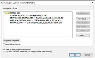

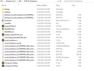

I have imported several projects from SDK 1.30 at this point and for some reason my builds are all failing because the eww template is not including the startup_mspm0l130x_iar.c file:
I see the file is even in the SYSCTL_Shutdown workspace directory, but the compiler's not finding it. Is it expecting an actual "iar" folder?
Munan
  • OK quick update I did manually add an "iar" directory and put the startup file in there and the build worked. I think this is some sort of project setup issue with the template...

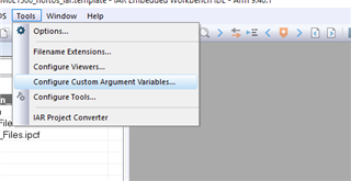

    Remember to check that whether the SDK version set in the configuration is same as the SDK version of the example code you used.
    3). Don't open the IAR project in the example file, you need "open workspace" or " Add existing Project".
