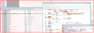

We are using AM2634 MCU and MCAL 9.1.0 version.
Please let me know why exception is occurred at D cache enabled.
If only I cache enabled, there is no exception and working normally. But once enabling I cache and D cache, exception is occurred.

    The peripheral address space should always be configured as Strongly Ordered to ensure maximum safety during the access of peripheral registers. This may impact the write speeds.

    Can you explain the which area is Peripheral space should I set?
    from 0x3500 0000 to 0x6FFF FFFF, is this region should be set Strongly Ordered?
    And how about ATCM area? is this area to be set to Outer and Inner Non-cacheable?
    R5SS0_CORE0_TCMA_ROM 0x0000 0000 0x0001 FFFF 128K
    R5SS0_CORE0_TCMA_RAM 0x0002 0000 0x0002 FFFF 64KB
    This is what ARM documentation mentions about TCM MPU settings -
    This is good or you can keep the entire 2GB to set as Strongly Ordered and set the settings of cacheable for RAM etc in the subsequent regions.
