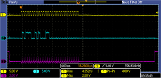

The bridge is host only, and is verified to output data (I can see waveforms on oscillograph). LP-AM243 connected to PCI11400 through SPI3 pins (J1.13, J2.6, 12,14 even though CS apparently is not needed). Software on the Texas side uses parts of mcspi_loopback_dma example, and also works if the device is configured in host mode - once again, I've seen waveforms. However, if the configuration is changed for device mode, transmission does not occur.
While I can see CLK signal oscillating, the transfer does not happen. Additionally, if I try to change the configuration for polling and step over the program, the interrupt never happens and CSL_MCSPI_IRQSTATUS is always zero.

  • Hello, Vaibhav.
    1. Unfortunately, it appears I can not upload the datasheet, as it is NDA only. However, I have attached a screenshot of the waveform for you to confirm it.

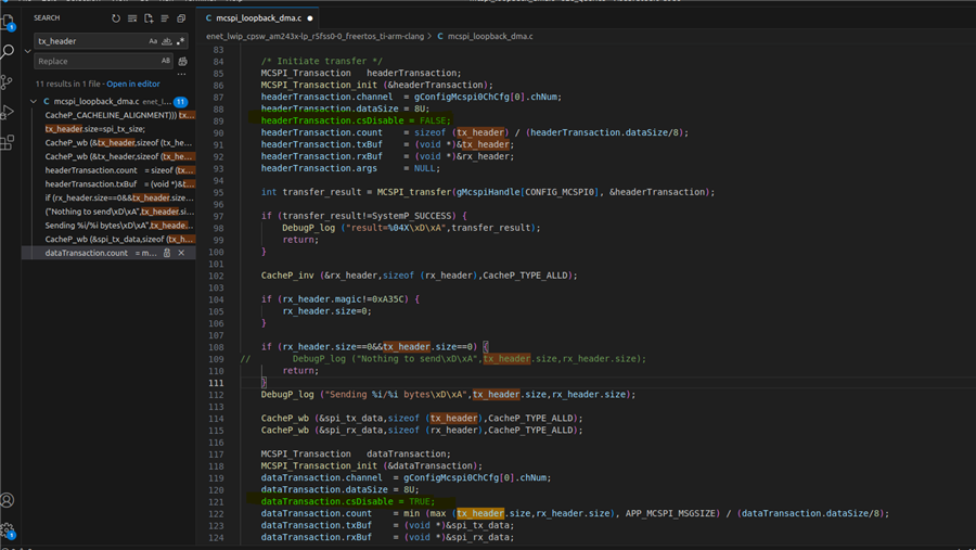

    It would be nice to get the project file you have created with SoC_SPI3. I would need to look at the code and apart from this I would also like to know about the hardware connections via jumper cables/wires which you made from SoC_SPI3 to the Peripheral.
    Looking forward to your response.
    NOTE: Let me know if you are comfortable sharing the project file here or over mail, accordingly you can send.
    Vaibhav

  • Hello Gennadi,
    I had a chance to go through the code you sent over mail.
    Can you please explain the reasoning behind setting the first CS Disable to False and the subsequent CS Disable to True ?
    I believe both should be set to True.
    Also could you explain what is the first SPI Transaction doing and what the second one is doing.
    Vaibhav
    as  i have mentioned in a email, this piece is a leftover from the debug. I have tried both with CS Disable set to true and false, and, as I've been sending the code to you, I didn't completely replace the variable.
    The first transaction is supposed to transcieve the header with sizes of a main payload, while the second transaction transcieves the data itself.

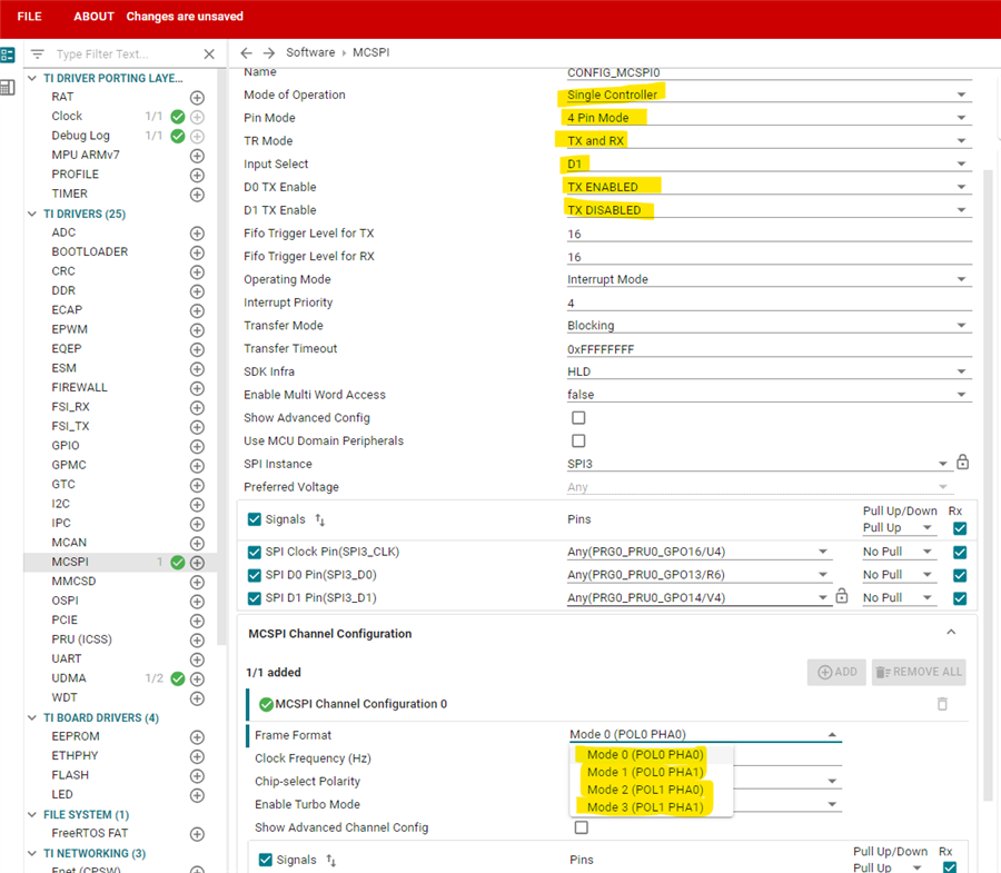

  • Hi Gennadii,
    Thanks for your patience.
    I would say that the code you have written is correct.
    The only concern I would have as of now, is to check if the SysConfig settings are done correctly for you. (NOTE: The project you sent me over mail does not contain the SysConfig settings.)
    I want you to make sure that the MCSPI peripheral actually supports the Mode 0 operation which is default Frame Format.
    In case it does not, then there are four different frame formats you can choose from as highlighted at the bottom of the attached screenshot.
    Moreover, I want you to make sure that the connections are correct and the wires are not faulty. For example with the above configuration as highlighted on top of the attached screenshot, I would simply connect my Controller's D0 line to Peripheral's MOSI line and Controller's D1 line to Peripheral's MISO line.
    Can you please confirm the above information?

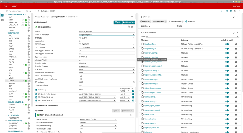

  • Hello, Vaibhav.
    First of all, why would you configure AM243x in the controller mode? AM243x is supposed to work in device mode, which is set up as expected (see attached screenshot).

  • Hi Gennadii,
    Your SysConfig configuration looks good along with the code as well.
