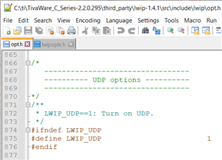

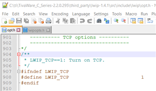

    I have another question about this example. I want to merge it into my application, and for my understanding, I need to enable the LWIP_UDP flag under lwipopts.h to ensure that the magic packets can be received through UDP port 9.
    I'm using LWIP_TCP for my application. Enabling both can cause me problems?
    Tzipi
  • Hi Tzipi,
      If you want to use both TCP and UDP then you need to enable LWIP_TCP and LWIP_UDP. Refer to the opt.h file. These two #define are optionally defined at the application level using lwipopts.h file. If they are not defined in the lwipopts.h file, then they are both set to 1 in the opt.h file. This means setting both to 1 will not create a problem.
