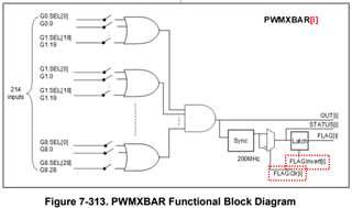

I found an incorrect description in Figure 7-313 of AM263x TRM (SPRUJ17F).
Hello Jeeuk,
Can you elaborate what you believe is wrong about the description?
Ralph Jacobi
In the figure, left mark is a selection of a just buffer or an invert buffer.
And right mark is a latch block.
The FlagInvert should be connect to left mark and the FlagClr should be connected to right mark.

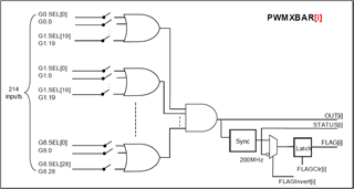

Hi Jeeuk,
We did a more detailed review of this diagram with a design expert and your feedback is on point but also there was an error with how the Status output is being pulled too:
You'll see the Status is pulled before the inversion now.
This will be reflected in the next TRM revision.
