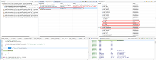

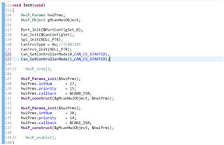

When I was using Autosar OS, I would call the critical section protected interface, but I found that at some point my interrupt(priority 15) still triggered after I set IRQ_PRIMSK(0xFF).
As shown in the figure below, I recorded the register information of the exception time and can see that the value of IRQ_PRIMSK was set to 0xFF, but the interrupt with priority 15 was still triggered.
The code to manipulate the IRQ PRIMSK register is shown below

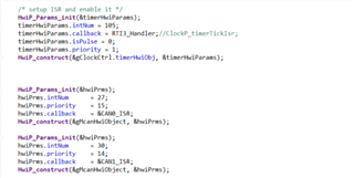

    This is my interrupt configuration:
    This is my test procedure:

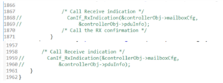

    2. Mask CanIf callbacks in Mcal(Can_irq)

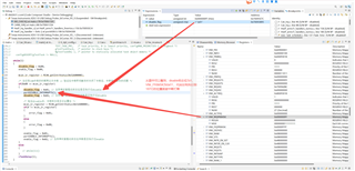

  • Hi,Akshit!
    I did two new tests:

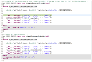

    First:I use the FreeRTOS routine provided by Ti to replicate this problem,I even added the following code to the critical section operation.
    Here is my test code:
    I send multiple messages through the host computer to trigger the CAN interrupt
    Second:
    I discussed this issue with Zhang Fan and made the following two guesses:
    1. Setting IRQ_PRIMSK between the interrupt flag set to 1 and the trigger of the interrupt does not effectively disable the trigger of the interrupt?
    Based on the above guesses, I did the following test:I checked the relevant interrupt flag before disabling the interrupt to make sure that no interrupt occurred and that the flag bit was set to identify where the code was executed. The test result shows that my disable_flag=1 and irq_primsk=0xFF, indicating that after I executed 185 and 186 lines of code, the interrupt was still triggered, but this test is not rigorous, the interrupt may be triggered between 183 and 186 lines.
    2. How long does it take for the IRQ_PRIMSK Settings to take effect? Will an interrupt be executed if it is triggered before it takes effect? That's a question I can't verify right now

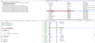

  • Hi, Akshit,
    I did some test with SDK example and AM263x EVM, and re-produced some issue as customer encountered. I summarized my test results as below, hope it helps in your analysis.
    1. I testes with gpio_input_interrupt example from SDK 09_01_00_41, the priority of GPIO interrupt is 15. By setting VIM_IRQPRIMSK from 0xFFFF to 0xFF, GPIO interrupt will not be triggered, it is the expected behavior, and it indicates VIM_IRQPRIMSK can be used to mask desired priority interrupts.
    2. In real use case, VIM_IRQPRIMSK is changed between 0xFF and 0xFFFF very frequently to mask interrupts with lower priorities when needed. Then, I add some code in the while loop to modify VIM_IRQPRIMSK continuously, and at the same time, press SW button in EVM to trigger GPIO interrupts. In every tests, it can run into the condition that VIM_IRQPRIMSK is 0xFF, but GPIO(priority = 15) interrupt is triggered.
    3. In the test code, I check the GPIO interrupt flag register before change VIM_IRQPRIMSK to 0xFF, to make sure there is no pending GPIO interrupt.
    Attached is my examples\drivers\gpio\gpio_input_interrupt\gpio_input_interrupt.c, you can just use it to overwrite same file in your SDK, then continuously press the SW key in EVM, when the log from UART stops to update, the issue is re-produced.

  • Hi Fan Zhang,
    Apologies for the delay and than you for waiting so patiently.
    You are right!
    There is a detected issue with VIM PRIMASK which  would be able to explain better.
    The SDK team is working on a fix for the issue.
    Since this fix needs some latency and performance profiling to be done, we will not be able to have it as part of SDK 9.2 release (end of this month). We will have the fix in GitHub soon after 9.2 release and have it as part of SDK 10.0 release (August 15th). We will also share the patch here as soon as the SDK update is done.
