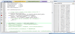

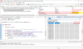

I am working on MSPM0L1306 Launchpad where I have some Temperature values which User need to Set. After setting the Temperature values updated value should be stored in flash memory which I can do by following functions:
/* 32-bit write to flash in main memory */
DL_FlashCTL_unprotectSector(
FLASHCTL, MAIN_BASE_ADDRESS, DL_FLASHCTL_REGION_SELECT_MAIN);
gCmdStatus = DL_FlashCTL_programMemoryFromRAM32(
FLASHCTL, (MAIN_BASE_ADDRESS + 16), &gData32);

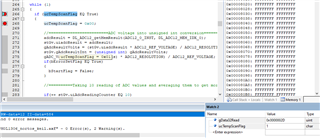

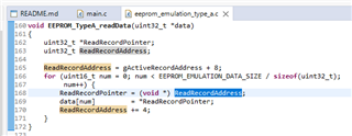

but after device restart that stored value should be read from flash memory. But in the examples I only have readVerify() function and in dl_flashctl.h there is only readVerify() functions are defined.
While reading from readVerify() giving error because
DL_FLASHCTL_COMMAND_STATUS DL_FlashCTL_readVerifyFromRAM64(
FLASHCTL_Regs *flashctl, uint32_t address, uint32_t *data);
*data is not same as stored value.
Can you please help me to read the data from memory?
