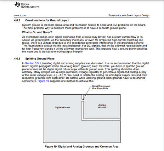

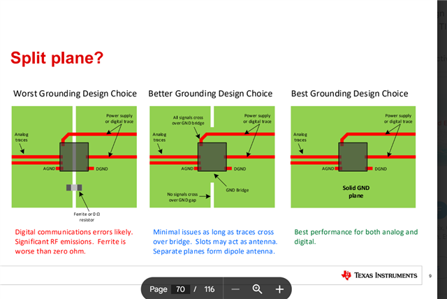

What is the purpose of TI putting a VSSA on MCU? let's say AM26X or the latest for real-time control. as long as I know that the best PCB layout for GND is to have a solid GND plane. Also, the PCB Layout guide for EMC  from TI said that we better have a solid GND plane. I saw some of the guidelines for TMS320F28335 still recommend splitting the GND, well which one should I follow?
