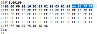

I tried remedying this by moving the BSL_Invoke pin to PA2, which happens to have a pull-down on our board. I did this by first inspecting the memory in the NONMAIN flash section, copying the existing values and modifying only registers BSLCONFIG0 (0x41C0010C) and BSLCRC (0x41C00154). A new C source file was created:

__attribute__((section(".BSLConfig"))) __attribute__((retain))
const uint32_t bsl_config[] =
0x00000001, /* 0x41C00100 - BSLCONFIGID */
0x02150216, /* 0x41C00104 - BSLPINCFG0 */
0x03020301, /* 0x41C00108 - BSLPINCFG1 */
0xFFFF0287, /* 0x41C0010C - BSLCONFIG0 - PA2, HIGH, IOMUX7 */

0x0048FFFF, /* 0x41C00150 - BSLCONFIG1 */
0x561226C8 /* 0x41C00154 - BSLCRC */
After flashing, I tried power cycling the microcontroller several times and I could see it jumping straight into the main program.

This is where it gets confusing. I had to work on something else and upon returning to it a couple of hours later, it would no longer allow me to connect to it.
When trying to connect to it within CCS, the following would be reported:
Error connecting to the target:
Could not connect to target.
I tried connecting to it through the J-Link Commander console. This is the output:
Connecting to target via SWD InitTarget() start DAP initialized successfully. No PWR-AP detected. InitTarget() end - Took 11.3ms Found SW-DP with ID 0x6BA02477 DPIDR: 0x6BA02477 CoreSight SoC-400 or earlier Scanning AP map to find all available APs AP[0]: Stopped AP scan as end of AP map seems to be reached Iterating through AP map to find AHB-AP to use Attach to CPU failed. Executing connect under reset. DPIDR: 0x6BA02477 CoreSight SoC-400 or earlier Scanning AP map to find all available APs AP[0]: Stopped AP scan as end of AP map has been reached Iterating through AP map to find AHB-AP to use Could not find core in Coresight setup InitTarget() start DAP initialized successfully. No PWR-AP detected. InitTarget() end - Took 11.3ms Found SW-DP with ID 0x6BA02477 DPIDR: 0x6BA02477 CoreSight SoC-400 or earlier Scanning AP map to find all available APs AP[0]: Stopped AP scan as end of AP map seems to be reached Iterating through AP map to find AHB-AP to use Attach to CPU failed. Executing connect under reset. DPIDR: 0x6BA02477 CoreSight SoC-400 or earlier Scanning AP map to find all available APs AP[0]: Stopped AP scan as end of AP map has been reached Iterating through AP map to find AHB-AP to use Could not find core in Coresight setup Cannot connect to target.
I found a similar thread on this forum which suggested running the MSPM0_Mailbox_FactoryReset_Auto() script, but as I don't have an XDS110, this is unfortunately not an option.
And ideas how I might be able to salvage this chip? I'm hoping to avoid having to transplant a new IC onto this board.
