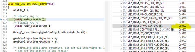

Running the GPMC sample code of SDK (am263x_09_01_00_41), I am setting the GPMC_CLK_SRC_SEL using a GEL file before main gets to run. When reaching HwiP_enableFIQ(), the value is modified.
Is it intended?

The Hwip_enableFIQ() just changes F bit of CPSR register, it doesn't change the clock source for GPMC. I think that 0x2 (system clock) is the default clock source for GPMC.

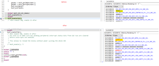

My test shows that the GPMC clock source is 0x222 before calling Hwip_enableFIQ() and after calling Hwip_enableFIQ() .
Before calling Hwip_enableFIQ():
After calling FIQ enable function:
Thanks for checking QJ,
Instead of running step-by-step, I added a watchpoint when writing to the GPMC_CLK_SRC_SEL register, and then saw that it was the setting on gSocModulesClockFrequency what was causing this change. Modifying the values within it fixes the issue.
