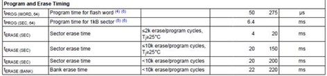

Is there the ability to run the program while the Data Flash is being updated (erased + written)? (Can the program run with the update process deferred to the task?) Or will it be the time wait below during the update?
    Not in this device no, you would need to have a device with dual-bank memory (those are not yet available, but are planned). You could run from SRAM while updating the flash memory, but that would be complicated to implement, as you must ensure you do not accidentally jump back to executing from the flash memory you are writing to.
