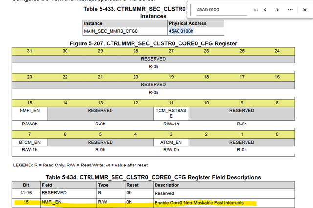

  • Hello Felix,
    I am able to reproduce  the issue and found that, as of now, on the SOC, these NMI masks normally acts normally interrupts .
    In the register below there is the 15th bit, by default this bit is zero. If you set  this bit 1 to enable NMI and see still facing the same issue or not.
    Make sure that you change only the 15th else it will update other settings values of R5F core.
    S.Anil.
  • Hey Swargam,
    So I tried setting the bit as you can see here:
    I did set it like this:
    CSL_REG32_FINS(CSL_MAIN_SEC_MMR0_CFG0_BASE + CSL_MAIN_SEC_MMR_CFG0_CLSTR0_CORE0_CFG, MAIN_SEC_MMR_CFG0_CLSTR0_CORE0_CFG_NMFI_EN, CSL_MAIN_SEC_MMR_CFG0_CLSTR0_CORE0_CFG_NMFI_EN_MAX);
    anyway the interrupt does not occur unfortunately.

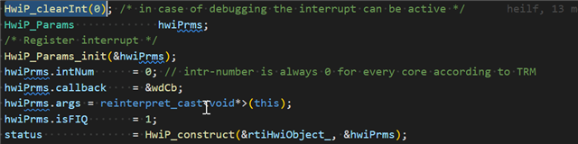

  • Hey Anil,
    this is a bit crazy but it seems to work, just not as intended. It now throws an interrupt directly after the watchdog is started (so, right after calling Watchdog_open). This wasn't the behaviour normally. Anyway I removed our restart callback to monitor if the following normally expected interrupt occurs and yes. After expiration of the watchdog-window an interrupt is thrown as expected.
    So overall we have two interrupts now with the first one being unexpected directly after starting the watchdog. Is this related to the FIQ?
    Also those changes can be integrated easily by us, since we wrote our own Watchdog-Drivers above the SDK-API without SysCfg.
    We just need to prevent that initial interrupt.
    I also cleared the interrupt before creating it like this:
    but that didn't help.

  • Hello Felix,
    Thanks for confirming results .
    Even if you configure the watchdog interrupt as  FIQ and not setting up the 15th bit of the CTRLMMR_SEC_CLSTR0 Register will work for you.
    Since ,  we disable only the IRQ's and not the FIQ's in entire MCU+SDK .
    So, even if you configure a watchdog interrupt as FIQ, it should work.
    I am not sure whether we can control the CTRLMMR_SEC_CLSTR0 Register to enable NMI interrupts.
    I will get clarification from our internal Team and let you know.
    S.Anil.
  • Hello Felix,
    I have internally discussed with other teams and confirmed that there are no NMI interruptions on R5F core.
    So, your watchdog interrupt is also a generic interrupt and you can mask the watchdog interrupt.
    In the entire MCU+SDK we are disabling all IRQ interrupts in the critical section. So, when you configure Watchdog interrupts as FIQ, your watchdog interrupt is not masked by the Hwip_disable function.
    Conclusion :
    Configure Watchdog interrupt as FIQ. So, your Watchdog interrupt is not disabled when software calls the Hwip_disable  API.
