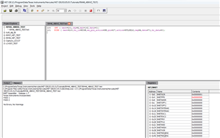

  • New Information.  I found the PWM generator in the HET IDE, and used it to generate the following code:
    ;PWM code for given HCLK frequency = 100MHz  ,PWM frequency = 0.048MHz  ,duty cycle = 0.5% ,HETPFR value =0 is below:
    L00 CNT {reg=A, max=2082, data=0}
    L01 ECMP {next=L00,hr_lr=HIGH,en_pin_action=ON,pin=8,action=PULSELO,reg=A,data=1041,hr_data=0}
    I put my oscilloscope on the output pin N2HET1[8], but the waveform measures 375 Hz, not 48 kHz.
    However if you do the maths 48,000/375 == 128, so the frequency is off by a factor of 128.
    So I look at the HET1 scaling register and find that the HALCoGen is default populating HETPFR[10:8] with binary '111', which corresponds to a 128 scale factor.  So, after loading the code, and booting, I overwrite the '111' in this register with'0', but get:

    After the HALCoGen integrates the code from the HET IDE *.h and *.c files for the program, I compile and load the code int the Hercules DEV Kit, run the code through the hetInit() which copies the program to HET RAM, I then
    --> modify the output HALCoGen startup code in het.c, and discover that when I change the value in HETPFR[10:8], as per below the following happens when I run the code(see table):
    HETPFR[10:8] in binary Frequency (Hz)
    111 375
    110 750
    101 1500
    100 3000
    011 6000
    010 12000
    001 (no clock output on pin 8)
    000 (no clock output on pin 8)
    So, just when I think I am going to succeed by putting '000' (binary) value into HETPFR[10:8], the timer outputs NO CLOCK AT ALL on pin 8.

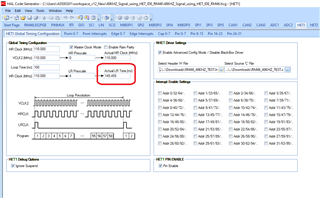

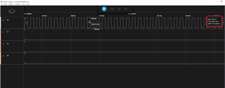

    Regarding this issue, i create one example project for you to generate the 48Khz signal using N2HET on HET1_27 pin.
    Here is the output:
    This is how i generated this signal.
    1. First i configured Loop Resolution value as minimum as possible,
    I configured this loop resolution as 145nS. If this loop resolution high, then we will get more error in the waveform. For more details refer below thread:
    (+) TMS570LS3137: PWM Capturing Code is working incorrectly - Arm-based microcontrollers forum - Arm-based microcontrollers - TI E2E support forums
    2. Based on this loop resolution value and required frequency, now i calculated the max value in the CNT instruction.
    Required Frequency = 48Khz
    Required Period = 20.83uS
    Loop Resolution = 145.45nS or 0.14545uS
    so, max value =Required period / Loop Resolution = 20.83 / 0.14545 = 143 (aprox)
    So, i configured final max value as 142.
    As i need 50% duty cycle, so i configured half of 142 that is 71 in the data value of ECMP instruction.
    3. After doing above things i generated the .h and .c from HET IDE and i configured same files in the HALCoGen. In addition i make sure the direction as output for the pin i am generating pulse.
    4. Now after generating HALCoGen code and program into the board i got 48Khz signal as shown in my first image.
