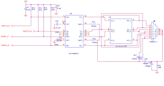

We are facing network detection issue in our msp432e401y custom board.
The schematic for the same is attached.
What could be the reason for the issue.

I don't really see anything wrong on your schematic except that you didn't show how you connect the RBIAS pin. If you didn't connect the RBIAS pin to GND through a 4.87kohm resistor then that will be a problem. Without RBIAS pin, you could also have improper JTAG connection issue as described in the errata.
