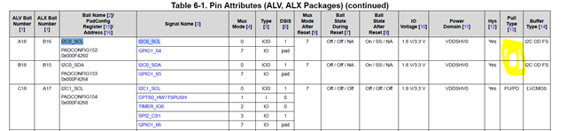

    Sorry for the delayed response.
    I found that the above pins do not support any pull up and pull down abilities.
    I have looked at I2C0_SCL and I2C0_SDA for ALV packages on datasheet in which Pull up and Pull down capabilities are not supported for those pins.
    Please look at the images below. I have highlighted the yellow color the PU /PD column is empty, which means that there is no support for PU/PD on these pins.
    I assume that the C19 pin for EXTINTN also does not have the PU/PD option.
    So, you can't control these PU and PD options from software. Even if you are trying to enable PU/PD from software there is   no effect.
    So, you need to connect externally resistors on those pins .
