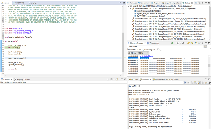

  • Hello Hang,
    As discussed internally, I understood that the customer is able to see the correct value getting assigned to global variable when the example is loaded & run with CCS debugger.
    The customer is seeing random value only when the example is flashed using SBL_OSPI. Meanwhile I have tried to replicate the issue on my end and I am unable to reproduce it.
    I have created a empty project in which a global variable named g_initialized is defined with 0x20 value in DDR section. When I load the symbols after flashing the SBL OSPI, I am able to see the SBL logs and also defined value getting assigned to global variable instead of random value.
    Please refer below screenshot.
    CCS Sample Project  - empty_am243x_evm_r5fss0_0_nortos_ti_arm_clang.zip
    Tushar

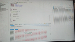

  • Hi Tushar,
    Thanks for the sample project. However, as the customer tried it, the global variable is initialized as incorrect values. Meanwhile, from the memory browser we can see that the memory in DDR is very different from yours. Any idea what might cause this issue?
    Hang.

  • Hi Tushar,
    Customer ran the project you shared on custom board without any changes. Since this project works well on EVM, it may be difficult to reproduce on EVM. Could you share with us the process of data copying so that we can check where it goes wrong? If the data are copied from FLASH to DDR in _c_int00(), we can check where data is stored on FLASH, then step through the _c_int00() to see the copy process.
    Hang..
