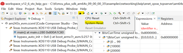

    I suspect that DMA channel is opened is owned by previously loaded binary is not closed properly. This is done by DM FW running on M4.
    So, we need to perform system reset to get a clean re-loading new binary.
    Can you try system reset in between 2 binary loading and update the results ?

    From Step 1 and Step2, you have flashed the tcp server on external memory and your application is running after changing boot mode to ospi.
    So, your application is using DMA channels and which need to be configured by SYSFW. Then, R5F requesting DMA channels allocation to SYSFW core  for your Application and it is allocated . This is fine.
    Now, you are not resetting the HW and loading example from CCC . At this step, again you requesting DMA channels for your application, then SYSFW will not allow your request since these resources are already allocated by SYSFW in flash time. So, you may get DMA channel open failure .
    Even if you do CPU reset does not help you since , CPU reset is mainly for local CPU reset and not for SYSFW  .
    To confirm my analysis is correct or wrong, instead of flash your tcp_server example, flash the Hello World example and try the same method and still see if you face problems or not.
    Try this below approach , you will not get any issue .
    Flash "Hello world example "  - > Load "tcp server example" from CCS - > System Reset from CCS - >Repeat

  • Please tell me how to reset the M4.
    If you are using ccs to load application for debug only.
    you can try "system reset" option shown as below
    Ashwani
