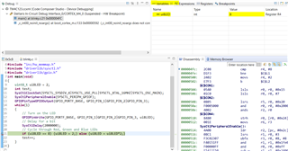

I am walking through the TM4C123G Launchpad Workshop Workbook, currently working on lab 2. After adding a watch expression for ui8LED just like the book says, I keep getting an error saying 'identifier not found' under the 'value' column. I tried the same thing with a 'test' variable with no luck. Optimization is turned off, and debug model is full symbolic debug -g. How do I fix this?
Here is my code:

expression pane
      ui8LED is a local variable inside the main(). You should open Variables window to see it. Expression window can view global variables. You can declare ui8LED outside of main() as a global and you will see it Expression window.
