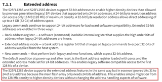

Good day Support
Previously we were asking about flash access here
We have updated SDK to 09.01.00.41 and tried to configure 4-byte addressing in SysConfig with some obvious values ( Addressing Mode 0x01/0x02, Supported sequence 0x20/0x21 )
The specified flash memory is marked as 'validated' in TI https://www.ti.comb/lit/an/sprad50a/sprad50a.pdf so I assume it should work out of the box.
Are there any documents that describe 4-byte addressing setup because I did not find any related example in SDK ?
Can you provide Addressing Mode / Supported sequence values for this particular case ?
Schematic
Thank you
