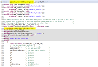

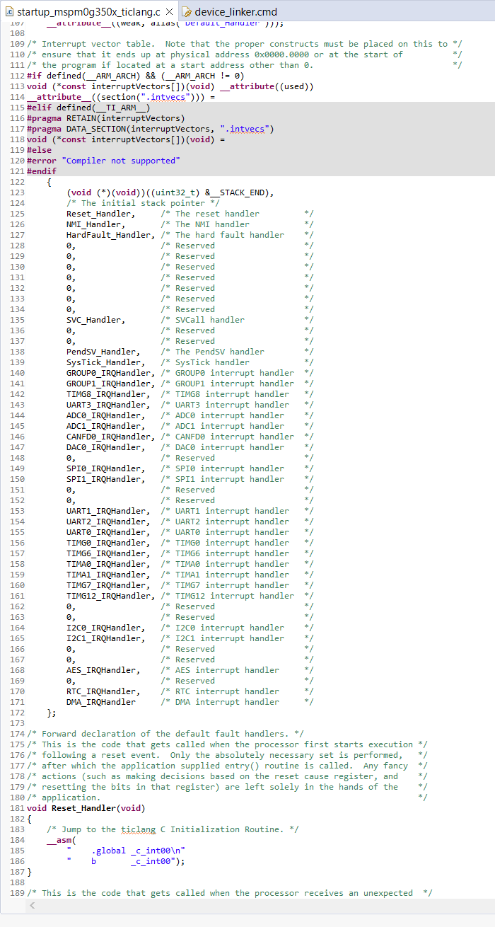

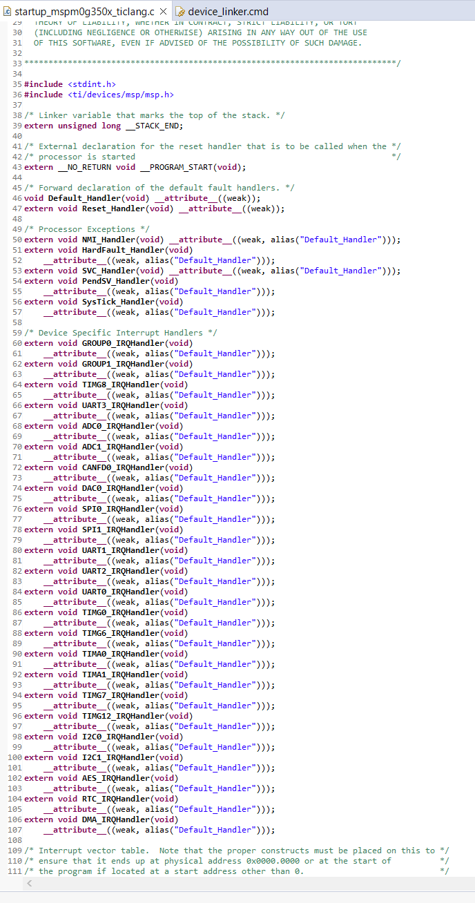

    Can you open the startup file and the .cmd file and send me a screenshot of them?
    These files can be found under the Referenced Source and Generated Source files that appear when you build the project.
    Luke

  • Hi Luke,
    Thanks for your support.
    Here are the files you asked for:
    Robert
