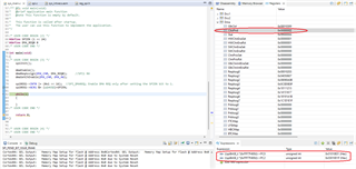

  • Hi Jarkko,
    Apologies for the delay in my response.
    Today i tested the behavior you are mentioned on my PC.
    Here is my output when the CS0 functionality enabled and it is connected with GND:
    In above image 0th bit in PC0 represents the CS0 functionality, it is 1 means CS0 functionality is SET to the CS0 not GIO.
    0th bit in PC2 represents the current input value of CS0, as you can see it is 0 (i.e. CS is GND).
    So, in this case DMA CH0 pending bit set, that is we received SPI RX DMA REQ.
    Here is my output when the CS0 functionality enabled and it is connected with 3.3V:
    In this case you can see CS0 functionality SET same as above but CS0 input value is now 1(i.e. CS is 3.3V).
    So, in this case DMA CH0 pending bit reset, that is we didn't receive SPI RX DMA REQ in this case.
    Here is my tested code for your reference:
    SPI_PEND_BIT_ISSUE_RM46.zip
    Thanks & Regards,
    Jagadish.

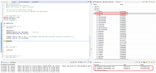

  • I'll believe your results but mine works differently. Could this differ based on CPU this one is RM46L852ZWT.
    Also having oscilloscope in CS0 to catch possible short down signals and scobe do not trigger.
    Starting situation
    And after disable (just wroted the disable bit with debugger)
    If I remove the CS from PC0
    And then make disable the PEND it not set
