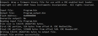

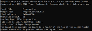

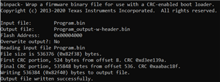

The main issue I am having is that BSL_Scripter sometimes (about 10% of the time) fails with "[ACK_ERROR_MESSAGE] Unknown Error!", which corrupts my application software. If the board is reset, it tries to run the corrupt application again, which essentially results in a bricked MSP432, which can only be recovered with JTAG (not possible when you only have ethernet access to it).
