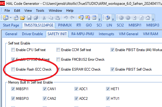

When I now want to be informed in case of a data/ecc mismatch when reading EEPROM data I need to configure the ESM.
Do I also have to activate the FLASH ECC when I only want to check the EEPROM (bank 7) ECC?

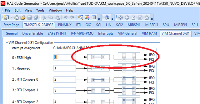

By the way why can't  this Interrupt not be dsabled or changed to FIQ in HALCOGEN?
    It is NMI(Non Maskable Interrupt), we can't disable it.

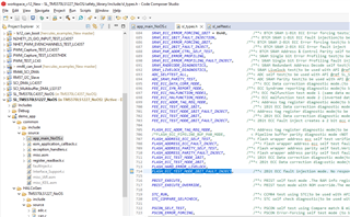

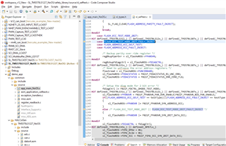

    Yes, we can do that using flash diagnostic modes.
    For more details about this implementation you can refer safeTI diagnostic library
    SAFETI_DIAG_LIB Driver or library | TI.com
    If you download this library, then you can import the project and you can see the definitions for the different diagnostics.
    As you can see, you can find the different fault injection codes for flash and FEE etc.
