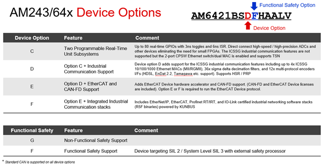

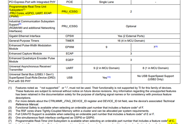

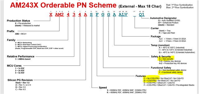

Is 'C' meaning PRU feature included or excluded?

Hi Zekun,
PRU support is included in device option C, but no Ethernet, Delta Sigma filtering, or multi-protocol encoder support is provided. Please see below table for reference.
