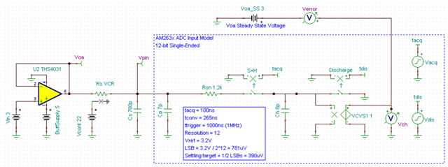

can you please direct me to where I can find the ADC input model for AM2634COKFHMZCZRQ1. It's mentioned on the reference manual that the values can be found on the datasheets, but I couldn't locate it.
Should I use the Ron and Ch values used in the example given in page 491 of the reference manual ?
can you provide the table for the pin capacitance for each of the analogue inputs ?
Yassine
  • Hello Yassine,
    We are working to get a TINA ADC Input Model provided on the product page. In the meantime, please use the information below to get started.
    n = 12 bits
    Ron = 1.2k
    Ch = 8pF
    Cp = 7pF
    Settling Error = 1/2 LSB
    Rs = Calculate
    Cs = 700pF
    The pin capacitance for each ADC pin is Ch||Cp
    = 15pF

    do all pins have the same parasitic cap ? you have a table like the following for the AM263x :
