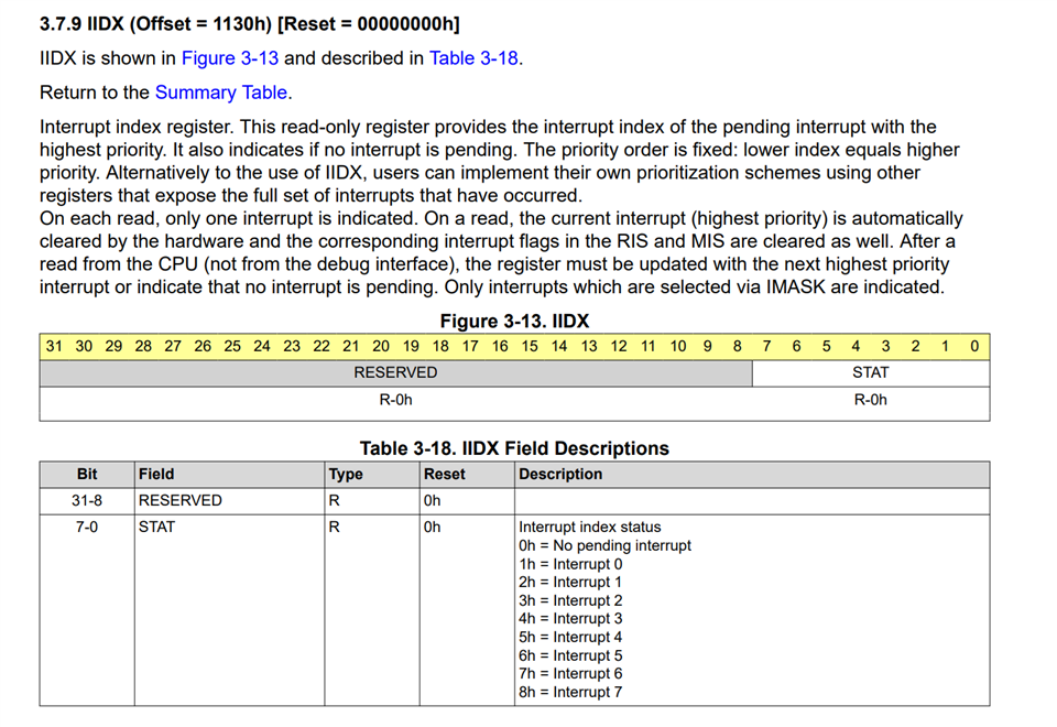

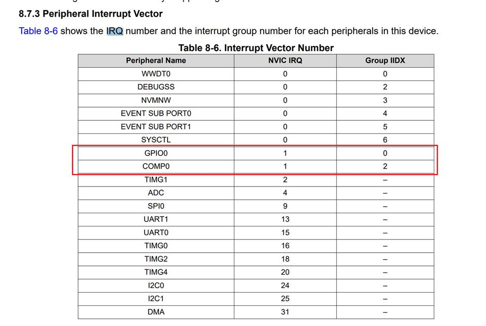

In Page 41 of the datasheet,
IIDX is 0 for GPIO0 and 2 for COMP0.

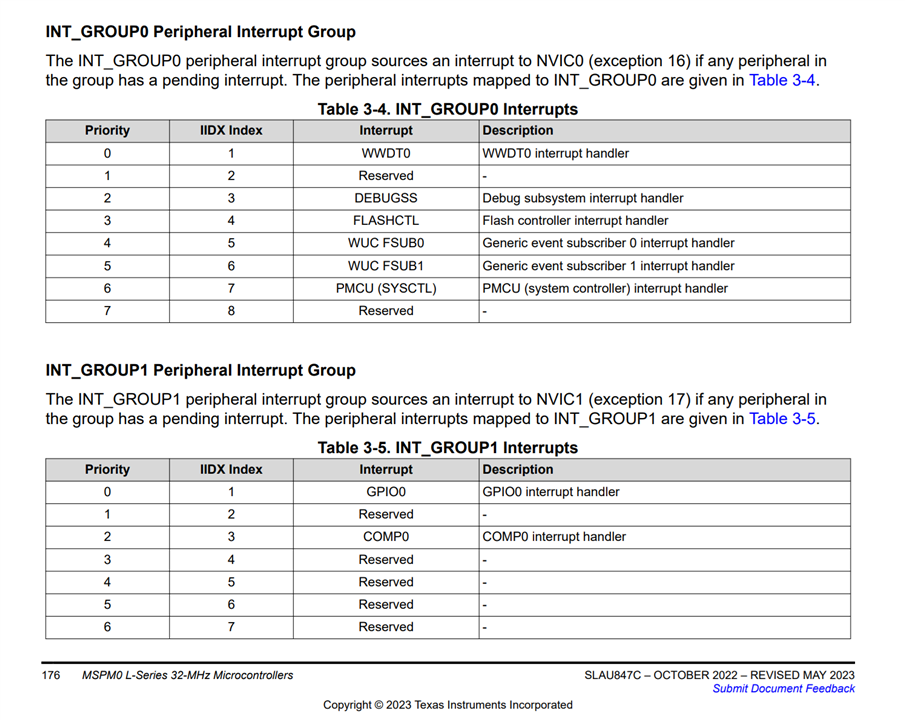

But in TRM, it shows below. IIDX=1 for GPIO0 and IIDX=3 for COMP0.
The user understands IIDX=0 means no interrupt pending.
However, is it better to make the above match with each other to avoid confusion?
