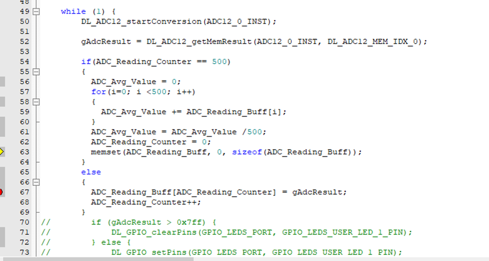

I am working on ADC12_0 and here is details of it:
ADC Clock Source: SYSOSC
ADC Clock Frequency 31.00MHz
Sample Clock Divider: Divide by 8
Calculated Sample Clock Frequency: 4.00 MHz
Conversion Mode: Single
Repeat Mode Enabled
Input Channel: Channel_0 (PA27)
Reference Voltage: VDDA 3.3Volt
Desired Sample Time 0 : 250uSec
Enable Interrupts: MEM0 result loaded interrupt
Kindly check the following code on which i am monitoring ADC values.
The fluctuation of values you can see clearly on attached pictures.

  • Hi, Seema
    That a long data table~
    After you start ADC conversion, you need to wait for ADC conversion done.
    In your code, you didn't wait and read adc result mem immediately.
    Check this code example in SDK, will help you how to handle ADC mem read sequence.
    C:\ti\mspm0_sdk_2_00_00_03\examples\nortos\LP_MSPM0L1306\driverlib\adc12_single_conversion

  • Hi Helic,
    Thank you for the reply but I already done that by using 10 mSec counter  and then start taking ADC conversion.
    I already gone through the code which you have mention and getting these value variation. Expecting expert reply from your side as I think there is something which I am missing to do and due to which I am getting this fluctuation in ADC values.
    The answer I am getting from your side is very basic and logical things which I already tried and after my query not getting resolved I came here on forum.
    I have checked number of similar questions on forum too but I have not get any answer. So expecting your expert answer.
    Thank you in advance.
    Please check this part firstly:
    In the demo code, MCU need to wait for ADC result ready by running [while (false == gCheckADC);], when result is done, gCheckADC = true in ADC interrupt, and MCU can read ADC result from ADC result MEM.
    int main(void)
        SYSCFG_DL_init();
        NVIC_EnableIRQ(ADC12_0_INST_INT_IRQN);
        gCheckADC = false;
        while (1) {
            DL_ADC12_startConversion(ADC12_0_INST);
            while (false == gCheckADC) {
                __WFE();
            gAdcResult = DL_ADC12_getMemResult(ADC12_0_INST, DL_ADC12_MEM_IDX_0);
            if (gAdcResult > 0x7ff) {
                DL_GPIO_clearPins(GPIO_LEDS_PORT, GPIO_LEDS_USER_LED_1_PIN);
            } else {
                DL_GPIO_setPins(GPIO_LEDS_PORT, GPIO_LEDS_USER_LED_1_PIN);
            gCheckADC = false;
            DL_ADC12_enableConversions(ADC12_0_INST);
    void ADC12_0_INST_IRQHandler(void)
        switch (DL_ADC12_getPendingInterrupt(ADC12_0_INST)) {
            case DL_ADC12_IIDX_MEM0_RESULT_LOADED:
                gCheckADC = true;
                break;
            default:
                break;
    For your code shown below, you didn't jam the CPU after ADC start. The CPU reads the results directly after the ADC is turned on, which will result in reading unknown results.
    Please add more functions based on the SDK demo.
    Helic
