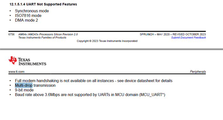

  • Hi Joshua,
    Apologies for delayed responses.
    As I was going through the TRM, I got to know that the MULTI Drop is not supported as of today as a part of TI's SDK offering.
    NOTE: Apart from UART if the Receiver supports I2C and SPI you can opt for it as I see your requirement is to send data from one point to multiple receivers.
    Vaibhav
  • Hi Vaibhav Kumar,
    thanks for your reply. I have seen that too and was just unsure because the multidrop function is described in the TRM detailed. But I have now solved it with  another way. Thanks anyway.
    Joshua
