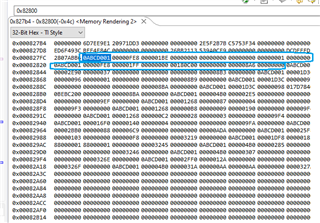

I want to check the RBL log data in my SBL.

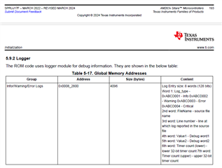

I have found the following chapter about the log data from RBL in the technical reference manual (TRM, SPRUJ17F) on page 194
I stopped the debugger in my SBL and looked into the memory browser.
Now I am a little bit confused, because I think the TRM information is not matching to the found data...
Can you give me some information about:
- log entry size , is it 8 x 32bit? with word size 32bit?
- the TRM speaks only from word 1 to word 7, what is with the 8th word?
- how many log entries can be saved from RBL, is the info 4096 bytes correct? --> that would mean 128 log entries at whole, is this correct?

  • Hi Aakash,
    thanks for the information.
    But I have still some questions, because the information on the academy site is in contradiction to the information of the technical reference manual and in contradiction to the memory browser view in my debug sessions.
    The first misleading information is the information about the memory location of the RBL log entries.
    The academy site says 0x80000, the TRM says 0x82800.
    What is the correct memory adress? With my AM263X-LP-board I need the address 0x82800...are there other variants/version of the RBL, which use the 0x80000?
    The second problem, I see, is the size of the "filename information". The academy says 8bit, the TRM says 32bit.
    In the memory browser of my debug session, I saw, that 8bits are not enough.
    And my third problem  is the maximum number of stored log entries? Is is 128 entries with 8 x 32bit (== 128 * 8 * 32bit = 4096bytes).
    Thanks and best regards
    Jo

    #2 The latest TRM version (SPRUJ17F – MARCH 2022 – REVISED MARCH 2024) - https://www.ti.com/lit/ug/spruj17f/spruj17f.pdf clearly covers each log data entry.

    We need a reliable termination criterion for ous parsing.
    The 1024 entries do not correspond with 4096 bytes, mentioned in the TRM (also in the newest version).
    Jo
  • Hi ,
    I will take this feedback and get this checked against the ROM code. Let me come back by tomorrow ?
