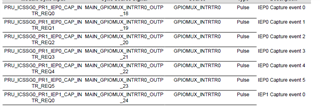

    You want to route GPIO interrupts for GPIO1_0, GPIO1_1 and GPIO1_2 pin interrupts to the PRU_ICSSG0 core ?
    First, we need to route these interrupts to PRU core in the Sclient_defaultBoard_cfg.c file.
    Please look at the image below. As per TRM,
    If you want to route any GPIO interrupt to PRU ICSSG0, we need to configure Router outputs from 38 to 45.
    If you want to route any GPIO interrupt to PRU ICSSG1, we need to configure Router outputs from 46 to 53.
    And these changes we need to configure in sciclient_defaultBoard_cfg file.

    In fact, I'm not using the GPIO interrupt outputs 38 to 45 and 46 to 53, rather outputs 18 to 20
    I would like to route GPIO1_0 -> MAIN_GPIOMUX_INTROUTER0_OUTP_18 -> PRU_ICSSG0_PR1_IEP0_CAP_INTR_REQ0.
    Similarly, 2 more GPIO interrupts to IEP0_CAP_INTR_REQ
    ICSSG0_PRU0 can configure the GPIO1_0 (dir and interrrupt edge) and IEP0 (CLK and capture interrupts), but not the GPIOMUX_INTRTR0.

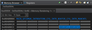

    PRU0 fails to execute the following command, and thus, I manually change it in the CCS memory browser to configure GPIOMUX_INTRTR0.
    HW_WR_REG32(0x00a0004c, 0x0001005a); //GPIO1_0 (GPIOMUX_INTRTR0_MUXCNTL = 90) -> MAIN_GPIOMUX_INTROUTER0_OUTP_18
    After changing it in the memory browser, the GPIOMUX_INTRTR0 is configured as expected.
    Now I would like to perform the same with SCI client from the ARM code instead of doing it manually in the memory browser.

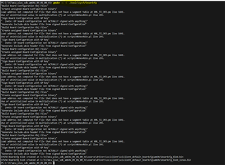

    I did the following steps.

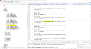

    1. I inserted the below given entries into the const struct tisci_local_rm_boardcfg gBoardConfigLow_rm.resasg_entries in sciclient_defaultBoardcfg_rm.c file.
                  .num_resource = 6,
                  .type = TISCI_RESASG_UTYPE (TISCI_DEV_MAIN_GPIOMUX_INTROUTER0, TISCI_RESASG_SUBTYPE_IR_OUTPUT),
                  .start_resource = 18,
                  .host_id = TISCI_HOST_ID_ICSSG_0,
    2. Modified .resasg_entries_size = 165 * sizeof(struct tisci_boardcfg_rm_resasg_entry) to .resasg_entries_size = 171 * sizeof(struct tisci_boardcfg_rm_resasg_entry)
    3. Then I opened cmd prompt and entered the following command, which shows an error in the makefile.
      C:\ti\ccs1250\ccs\utils\bin>gmake -s -C C:\ti\mcu_plus_sdk_am243x_09_01_00_41\tools\sysfw\boardcfg
      One of the boardcfg files provided do not exist, exiting blob creation ...
      makefile:131: recipe for target 'sciclient_boardcfg' failed
      gmake: *** [sciclient_boardcfg] Error 2
    Could you please help me to solve this error?
    Best regards.

    FYI, you can' write any data in to the GPIOMUX_INTRTR0_MUXCNTL  Register and, for this memory firewall does not allow you to write data in to this Register.
    You can only read them, and I am not sure how you are able to write in to this and did you see your changes in particular GPIOMUX_INTRTR0_MUXCNTL Register ?
    Yes, I can see the changes in the memory browser when I do it manually. Please see the image below.

    Unfortunately, it didn't work. Even when I run the command with the default files, it shows me the same error!
    Am I missing something?

  • Yes, I can see the changes in the memory browser when I do it manually. Please see the image below.
    Hello Sabari Kannan Muthalagu ,
    This is not correct. , In AM64X devices users can't write them in to these registers in earlier versions and  I have not verified in recent versions.
    I can check ,typically this register should not be written by users manually, since the resources are allocated through SYSFW.

    You need to run the command from mcu+sdk path .
    Please check the image below. And confirm you are running the command from the  same path ?
    Anil.

    I can run the command when I enter "configure-gen SOC=am243x" at the end of it.
    I referred - https://software-dl.ti.com/processor-industrial-sw/esd/ind_comms_sdk/am243x/09_01_00_03/mcu_plus_sdk/docs/api_guide_am243x/TOOLS_SYSFW.html
    Is that ok?

    From assumptions, I did the following changes.
    • Enabled ISSSG_0 under SYSFW REESOURCE PARTITIONING and entered 12 (max resource count) in Main GPIO Interrupt Router Count.
    • Ran the command gmake -s -C tools/sysfw/boardcfg configure-gen SOC=am243x
    • Now I see some changes in the sciclient_defaultBoardcfg_rm.c file. The following code is added.
                .num_resource = 12,
    Therefore I think 12 resources are now included and the resource output starts from 18. If my approach is right I'll proceed with the following steps. Please let me know.
    The above steps are OK.
    With the above command, the new rm_cfg file is updated with the old one.
    Do you have any reference which explains the necessary changes to be done to allocate GPIO INTRTR outputs 18 to 23 to ICSSG0 or 1?
    Please look at FAQ below.
    https://e2e.ti.com/support/processors-group/processors/f/processors-forum/1230630/faq-how-to-get-started-with-resource-partitioning-tool
    In the above FAQ we explained how to use the rm_cfg tool and I hope it will be helpful.
    As per the TRM, we can route route 12 router outputs to PRU core  and you did the same thing. This is also fine.
    Please go ahead for next steps, compile the SBL and load the SBL for new board configurations .

  • Hello Sabari,
    The above steps work for me.
    SciClient did not throw any errors.
    Can you please send your project to me?
    Did you compile the SBL after updating the sciclient_Boardrm_cfg.c file?
    I hope you have used the tool to generate new updated sciclient_Boardrm_cfg file because host id information also need to be added in file if you update sciclient_Boardrm_cfg.c manually
    We need to send source index would be 4 .
    Anil.
  • Hi Anil,
    Yes, I used the tool to update the config file and compiled the SBL after updating the config file.
    I'll send you the project asap.
    Best regards.
  • Hello Sabari,
    Please try with the SBL image below.
    Flash the SBL null image on your Hw, and on top it , load example from CCS.
    Please look at the Sciclient_boardrm_cfg.c file and application for your reference.
    Now, I am able to write the GPIO MUX router register with the SCI client configuration.
    Please let me know if you need any help.
