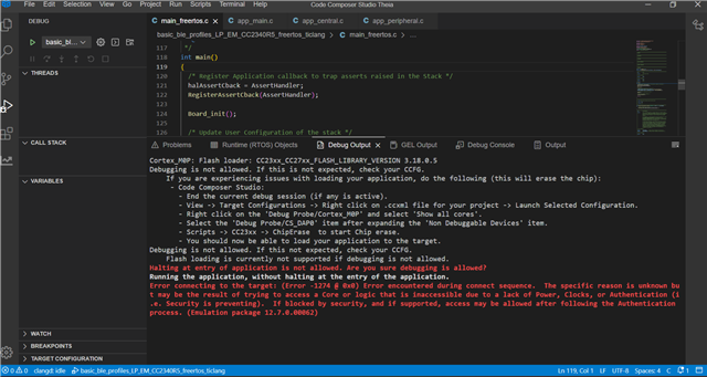

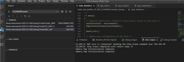

I just got the new CC2340R5 evm and it working fine at the beginning then suddently one of the EVM can not load program, I tried the steps suggested in the screenshot but it does not work. I tried swap the xds110 debugger and evm and confirm it is the the evm does not work.
