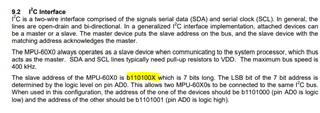

Dear Sir,
I want to receive accelerometer data from sensor MPU6050 using I2C. I can't get any data. What's my problem I don't understand? Is it initialization problem. Code is given below.

      Please refer to C:\ti\TivaWare_C_Series-2.2.0.295\examples\boards\ek-tm4c1294xl-boostxl-senshub\humidity_sht21_simple\humidity_sht21_simple.c example.
       In your code, you set the slave address to 0x1D. But according to the MPU6050 datasheet, the slave address is either 0x68 or 0x69. I will suggest you probe the I2C signals on a logic analyzer to make sure you have the correct address byte.
