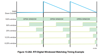

when integrated WDT in open window, code works fine. When 50% is used as window size, the code gets reset within just 2 lines of printing. It does not work as needed. How to properly configure window watchdog.

This is a power monitoring code. I have integrated watchdog timer in it. On 100% window( open window) it works as I intended. On using other window size, the code gets reset fastly.
  • Hello Anandakrishnan,
    How are you changing from the 100% to 50% open Window?
    Are you doing so through SysConfig?
    If so can you post your SysConfig file before and after the change so we can review how the change was done?
    Thanks, with the details you provided, I can see what is happening with your setup.
    The Windowed Watchdog operates by allowing only a certain window of time when the Watchdog timer can be reset. These windows are on the back half of the timer running:
    What you have set in SysConfig is a very long Watchdog, 5.3 seconds long, while your program code is going to execute significantly faster than this, and you are calling a Watchdog_clear each time the loop runs.
    The issue you have is due to this and how the Windowed Watchdog works. Specifically, "Any attempt to service the watchdog outside this time window, or a failure to service the watchdog in this time window, will cause the watchdog to generate either a reset or a non-maskable interrupt to the CPU." - Section 13.5.1.4.1 RTI Digital Windowed Watchdog of the TRM.
    So because your watchdog is in seconds but your code runs quickly, the you are triggering the reset by trying to service the watchdog outside the time window.
    To prove this, I added a ClockP_sleep(3); line above the Watchdog_clear in the while(1) loop to make the system wait 3 seconds before executing the clear each time the loop is entered. As the watchdog is 5.3 seconds long, this delay puts the device inside the 50% window, and at that point the code executes correctly once more.
    So if you want to use the Windowed Watchdog, you will have to fine tune your watchdog period to better reflect the time for your code to execute so that you are within the 50% window when the loop restart.
